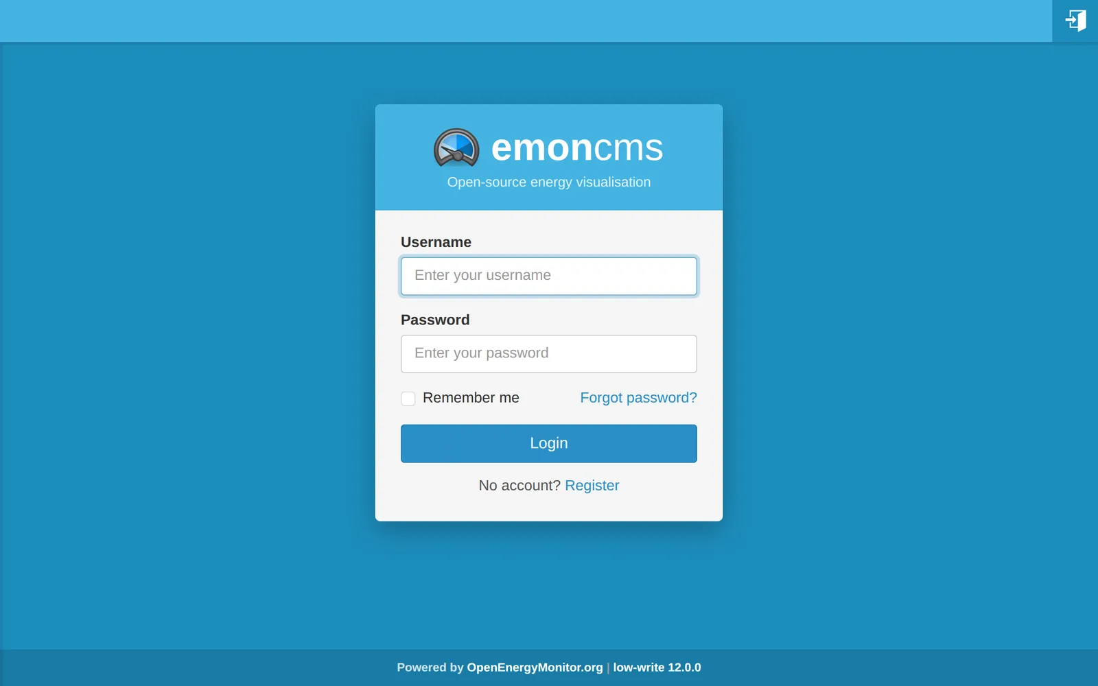

Open its address in a browser, for example
http://emonpi.local. The Emoncms login page appears.
Log in
Log in with username emonsd and password emonsd. Change the password afterwards on the My Account page.

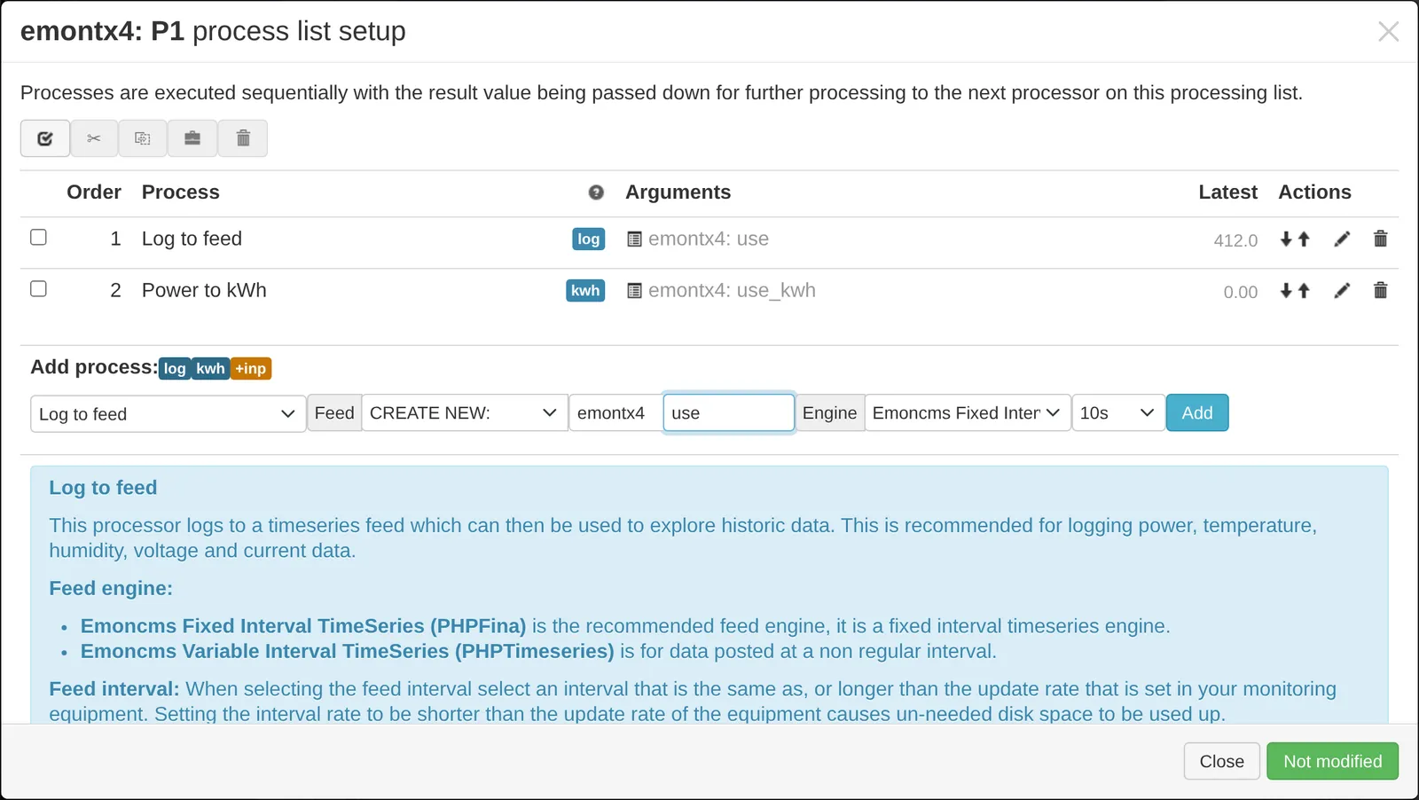

This example logs a power input, such as P1 from an emonTx4, and creates a cumulative kWh feed from it.
Click the spanner icon on the input.
In the process list dialog:
Select Log to feed.
Under Feed, choose CREATE NEW: and enter a name, for example
use.Leave Engine set to Emoncms Fixed Interval TimeSeries.
Select an interval of 10s for an emonPi or emonTx, or 60s for an emonTH.
Click Add.
To add daily kWh for a power input:
Select Power to kWh.
Create a new feed, for example
use_kwh, with the same interval.Click Add.
The emonTx4 and recent emonPi firmware also send cumulative energy for each CT channel. You can log those inputs in place of Power to kWh. See Daily kWh.
Click Changed, press to save, then Close.
The input now shows its processes as short labels, such as
logandkwh.

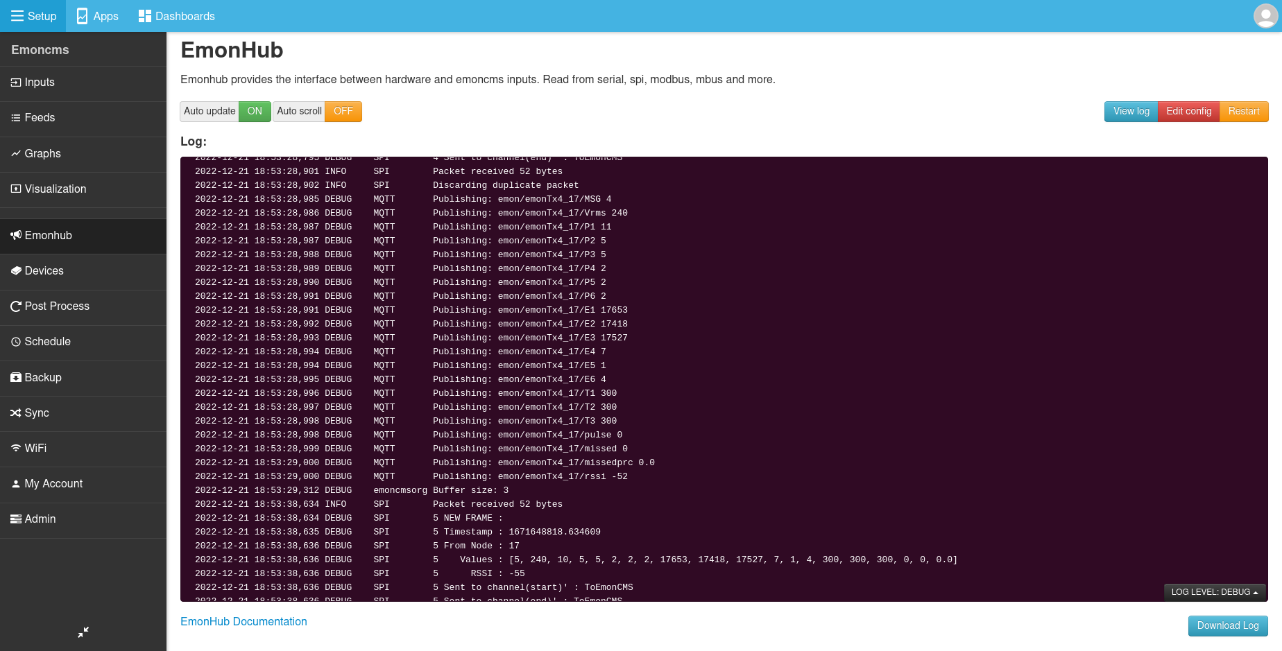

emonHub runs on the emonPi and emonBase alongside Emoncms. It reads data from the hardware and passes it to Emoncms over MQTT. It can also send data to emoncms.org.
Go to Setup > EmonHub to see the emonHub log. The log helps when inputs do not appear. Click Edit config to edit the emonHub configuration.

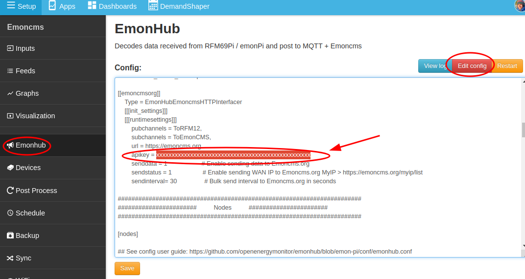

To send input data with emonHub:
Create an account on emoncms.org and copy the Read & Write API Key from the My Account page.
On the emonPi or emonBase, go to Setup > EmonHub and click Edit config.
Find the
[[emoncmsorg]]section and replacexxxxxxxxxxxxxxxxxxxxxxxxxxxxxxxxafterapikey =with your key.Click Save.
The inputs appear on emoncms.org within a minute. Set up input processing there as above.
