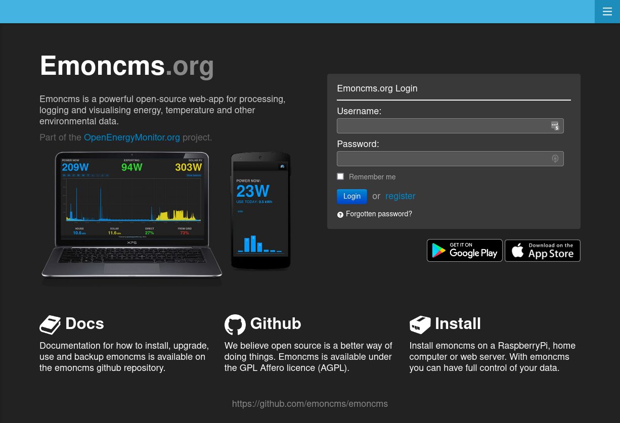

Create an account
  1. Open emoncms.org and click Register.
  2. Enter your email address, a username and a password. You need to verify the email address.

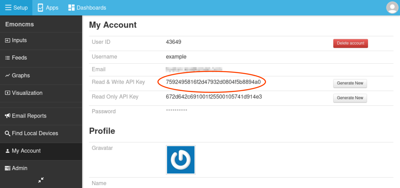

Find your API key
Devices and scripts use the Read & Write API Key to send data. Find it on the My Account page.
API key
