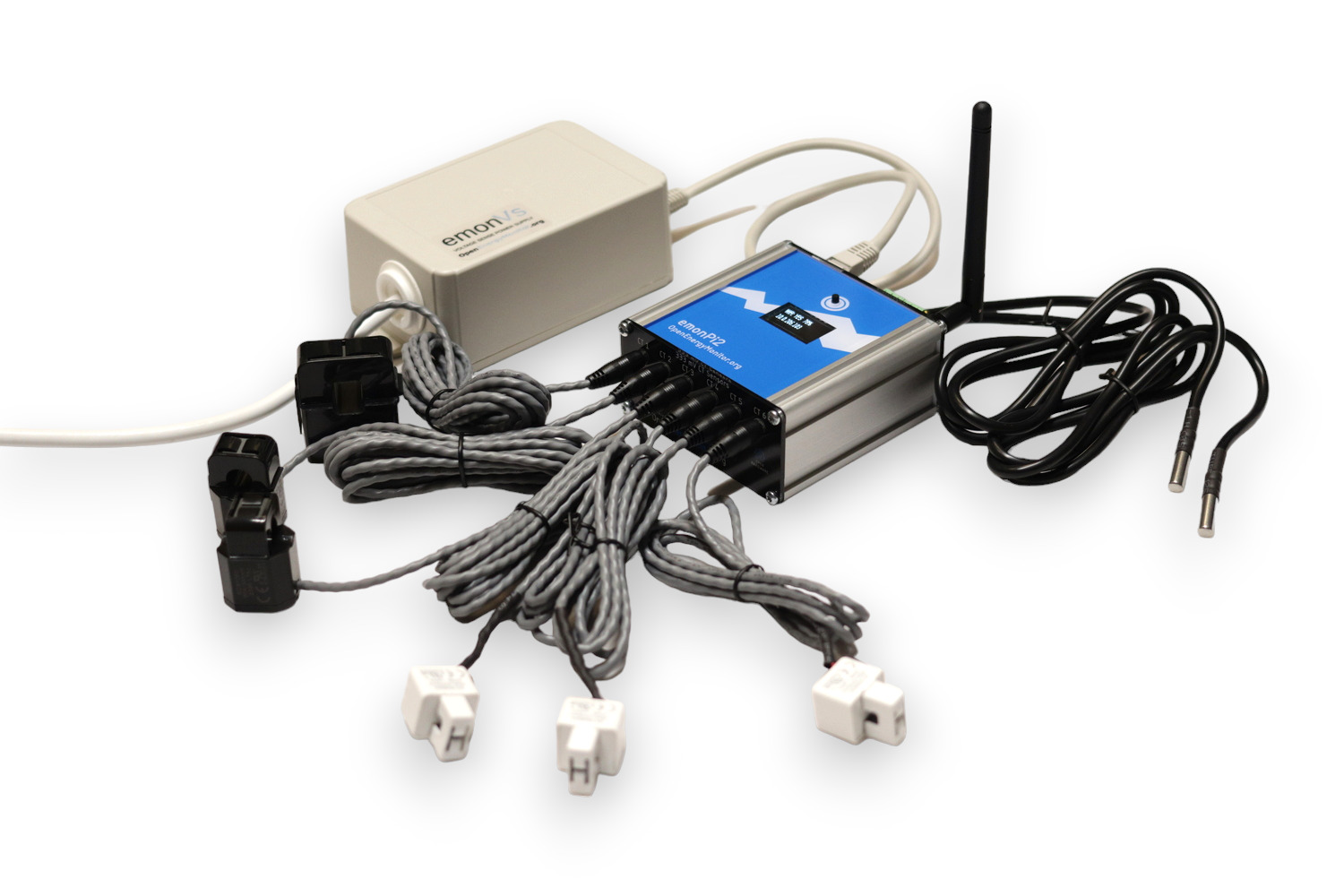

emonPi2: 6 input energy monitor
Up to 6 CT sensors
RJ45 voltage sensor and power supply cable

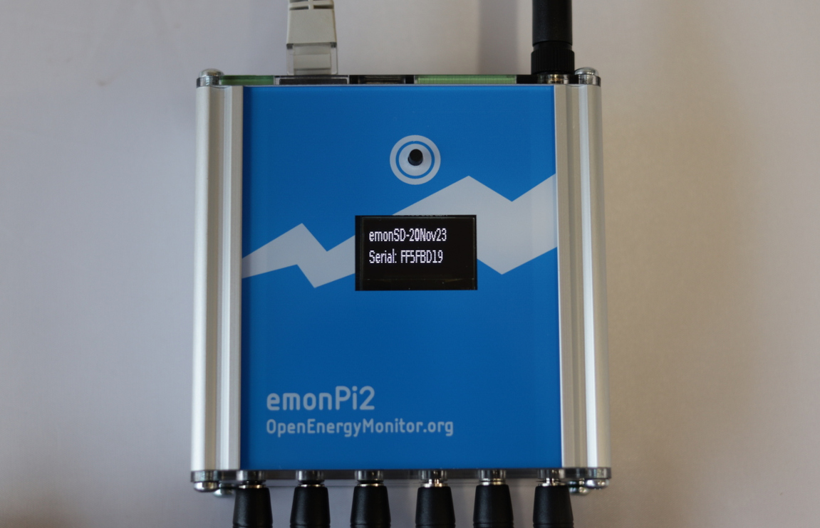

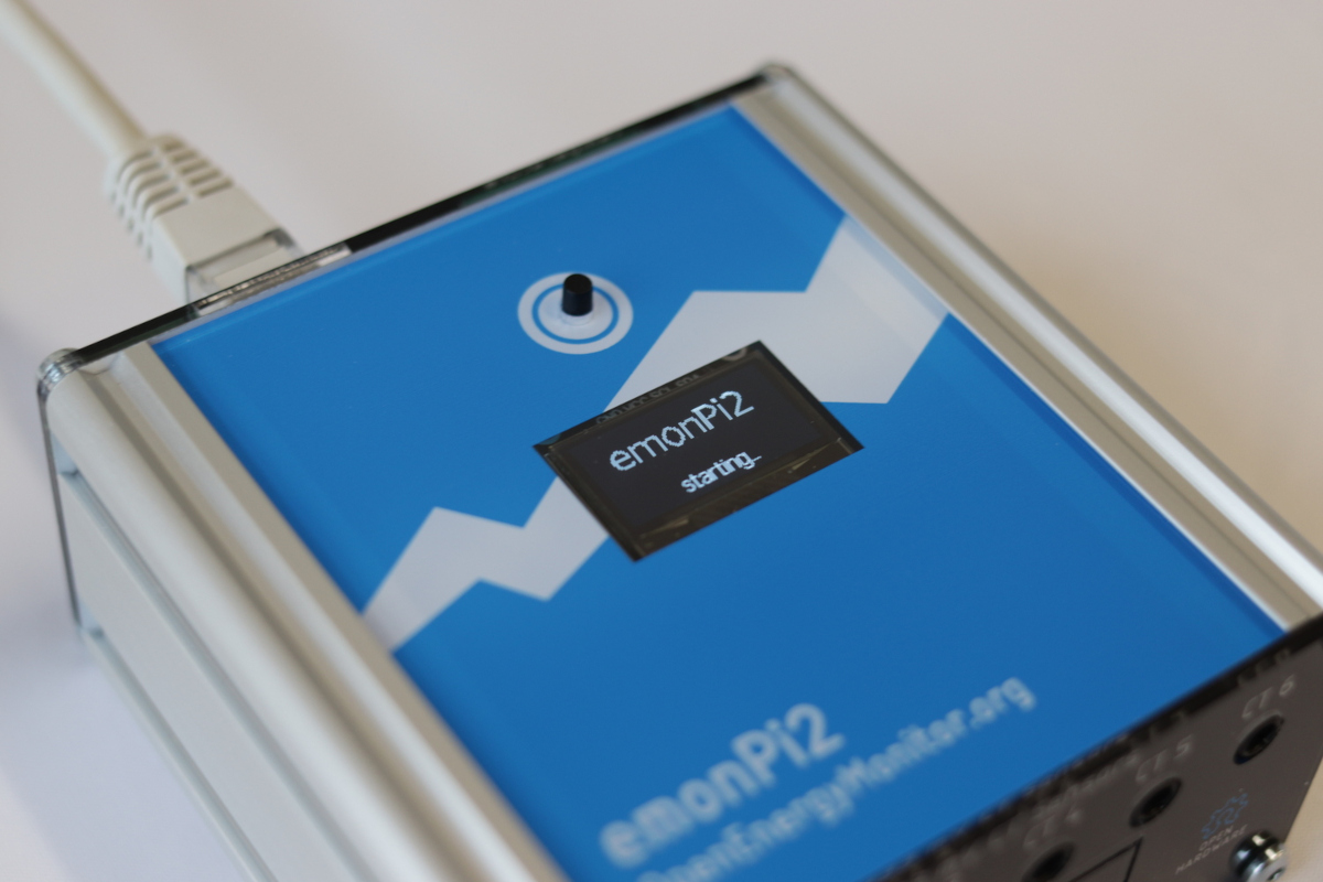

Switch on mains socket. The display on the emonPi2 will show
emonPi2, starting... On the SD card side of the case the RaspberryPi 4 indicator LED should be visible through the black face plate.If using Ethernet, continue with step 5. Connecting via Ethernet. If using WiFi, continue with step 6. Connecting via WiFi.

2. CT sensor installation
Current transformers (CTs) are sensors that measure alternating current (AC).
The emonPi2 supports a wide variety of 333mV voltage output CT sensors. We stock 20A, 50A, 100A & 200A options in the OpenEnergyMonitor shop. The physical size of these CT sensors is also roughly proportional to their current rating. For highest accuracy it’s a good idea to choose CT sensors that match the rating of the circuit being monitored. As an example a 20A CT should be used for 16A or 20A circuits, a 50A CT for 32A EV chargers or 100A CT for whole house monitoring (assuming a 100A rated supply).

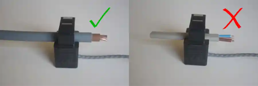

CT sensors need to be clipped around the Live OR Neutral cable of the AC circuit to be measured (not both). The CT sensors have an indicated direction printed on the case
K->L, where L is the direction of the load. That’s on the Line conductor, the arrow points away from the load on the Neutral. This will ensure the correct sign (+/-) on the power readings.
Take care not to compress the sensor with any sideways force as this can affect the accuracy of the measurement.
The new range of CT sensors used with the emonPi2 are all voltage output CT sensors with integrated burden resistors and so are safe to clip on to the circuits that you wish to measure before plugging into the emonPi2 if that makes installation easier.

3. emonPi2 Installation
The emonPi2 can be wall mounted using the wall mounting kit supplied. Installation on it’s side, with the aluminium side plates on the top and bottom can help reduce risk of things falling onto the sockets and can make for an easier installation in terms of CT sensor routing.
Plug in the CT sensors, note which CT sensor is plugged into each input on the emonPi2 as each input needs to have the correct calibration applied.
Connect the RJ45 cable (ethernet sized connector with 8 pins) from the emonVs voltage sensor and power supply to the RJ45 socket on the opposite side of the case to the CT sensor sockets. (If you have the RaspberryPi 4 variant of the emonPi2 the RaspberryPi Ethernet socket is on the same side as the CT sensors, avoid plugging the emonVs RJ45 cable into the Ethernet socket and vice versa).

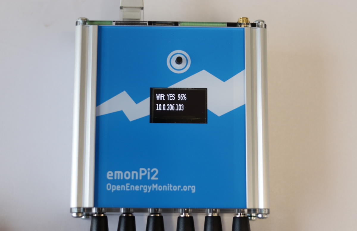

If a wired ethernet connection is available and you have the emonPi2 hardware that supports Ethernet (e.g RaspberryPi 4 shop option), this does usually give the most reliable result. We recommend using shielded Etherent cable to reduce potential electromagnetic interference. Simply plug the Ethernet cable into the Ethernet port found next to the USB ports and CT sensor inputs - NOT the RJ45 port used for the emonVs voltage sensor and power supply.
Scroll to page 3 on the emonPi2 display to find the assigned IP address.

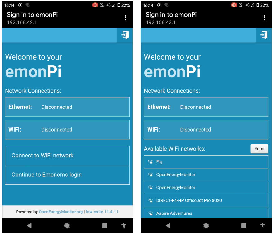

When the emonPi2 is powered up it will create a Wi-Fi Access Point called emonPi. Connect to this using password emonpi2016. On Android devices a captive portal option should pop up with the option to ‘Sign in’. This will bring up the Wi-Fi configuration interface.

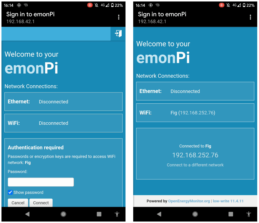

1. Click on ‘Connect to WiFi network’ to show the list of available WiFi networks. Click on the network that you wish to connect to.
2. Enter the WiFi network passkey (often found at the back of the internet router). Click connect. Connecting to a network and relaying the status update back to the user interface typically takes around 20 seconds. Note down the assigned IP address and use this to connect to your emonPi2 once you are connected back to your home WiFi network.

The Pi Zero 2W hardware option will usually drop the access point WiFi connection a few seconds after clicking ‘Connect’. Wait a few seconds, disable and re-enable WiFi on your phone, connect to the emonPi access point again and then bring up the network configuration interface via the ‘Sign in’ captive portal if available. The connection status and IP address can be accessed by reconnecing to the access point in this way.
The WiFi IP address can also be accessed by scrolling to page 4 on the emonPi LCD:

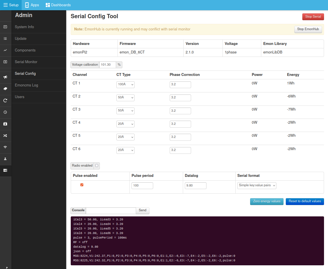

8. CT calibration selection
Different rating CT sensors e.g 100A, 50A, 20A etc, require differant preset calibrations.
CT calibration is usually pre-configured in the shop as part of the order process, but you may wish to double check that your calibration configuration matches the sockets that you have plugged the CT sensors into at this point.
Navigate to
Setup > Admin > Serial ConfigClick on
Stop EmonHubto temporarily stop the EmonHub service while we perform calibration.Select serial port
/dev/ttyAMA0and clickConnect.After a couple of seconds the emonPi2 will print out its current configuration which will populate the interface (if it does not do this type
land clickSendto reload the calibration details from the emonPi2 measurement board).Adjust the CT rating to match the CT sensor that you have installed on each channel.
Click on
Save Changesto ensure that the new configuration is recorded such that it persists when you power cycle the board.When finished, click on
Stop Serialto disconnect the serial configuration tool and thenStart EmonHubto restart the EmonHub service.

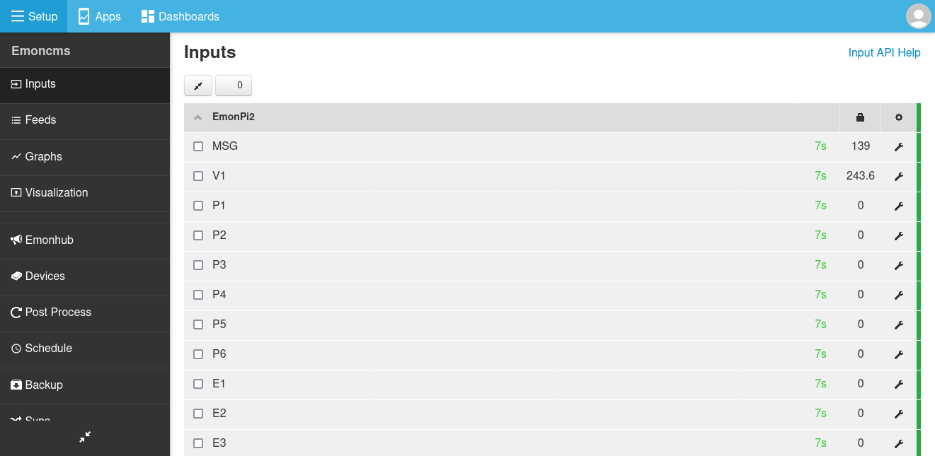

9. Setup input and feeds
Configure inputs by navigating to Setup > Inputs. The emonPi2 will pop up here automatically under the EmonPi2 node name.
The next step is to log the input data to feeds. Inputs are just placeholders showing the latest values sent from the emonPi2, we need to create feeds if we want to record a time-series of these values. It’s possible to either manually configure each input as required, or if you just want to record everything for now and delete what you don’t need later, then you can use the pre-configured Device Template.
